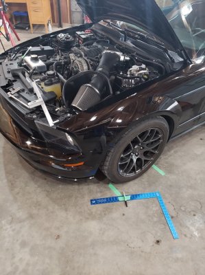

The 05-10 GT cars with the 4.6L eng all got the twin 55mm tb. ( FRPP sold a twin 62mm TB). 05-10 GT cars with roush M90 / TVS-2300 PD blowers all used the oem twin 55mm TB. I replaced my twin 55mm with the twin 62mm...drops right in.
