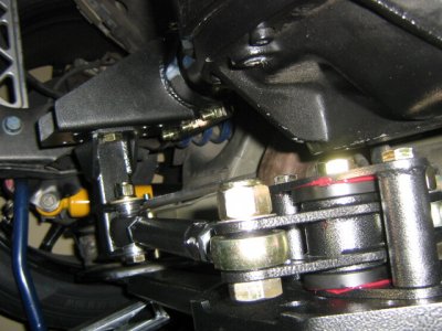

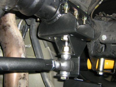

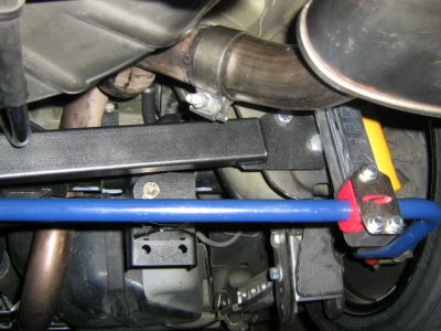

Quick update on my install of the BMR watts system. Finally got all of the right parts to work with my Ford Racing/Eibach sway bar. I ended up using the Steeda Rear Sway Bar Links (make sure you order the 22mm bushings/ comes with 3/4" bushings). Finished up too late tonight to test drive but glad it is done. I made some marks on the axle clamps/axle housing so I can easily tell if they move. Overall fairly easy to install. I benefited from Cobrareds videos. If you purchase the rod end version make sure you press the axle side rod end spacers in to the rod end with the bolt or some kind of press, otherwise it will drive you nuts trying to get it to fit in the bracket.
I was not able to use the rod end covers on the pivot side rod ends (not enough room). I'll post my driving impressions tomorrow and some pictures.

Awesome guys!
tbrock, I am glad to see you got it worked out. What diff cover do you have??
CobraRed, looking good sir!! How you liking it?

I have a Ford Racing (M4033G2) painted black. Love the way it feels on the car. I hit a few twisty that are bumpy and the rear end was much more settled than in the past.
I do have a question. How close is the frame supposed to be to the spare tire? At the top of the frame mine appears to rest on the spare tire area. I've got an occasional buzz that seems to emanate from the rear of the car. I'm assuming it is the frame/spare tire area. It won't do it idling just under certain loads. I may drop the frame to push the area in a bit to see if it goes away.

It will be between touching to 1/8".
That area is very very soft and easy to push in with a mallet if you want the space.
I didn't see any issues with resting the center mount against the wheel well when developing the kit - and we really didn't have any other option due to the design limitations.
