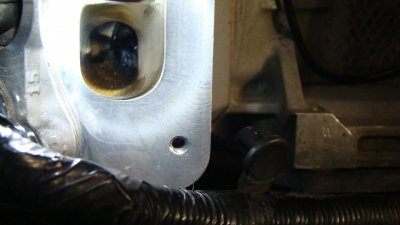

Livernois sold me and installed my FRPP/Whipple (Gen I after the Gen II had already been released without even discussing it). Livernois sold me and installed Stage 3 cylinder heads which were "new castings" which I had to wait a ridiculous amount of time for while Livernois developed their, now obvioulsy problematic, CNC program. All the while Dan told me believed these heads would out flow the old program. (I see why now considering I have measured ports on both). Turns out these cylinder heads received bronze guides from the "bad batch".
Livernois subsequently replaced these with a set of old cores with the old style spark plug and reinstalled the FRPP/Whipple. (Found this out after the fact when I went to remove the spark plugs when the car was FINALLY returned to me). These replacements heads will not seal and even have a suspect valve guide...given the track record of all this Im pretty sure we know where the problem is.
Mike I handed you four of my gaskets to include this gasket in the picture which obviously failed. Every one of my gaskets show some level of damage. You guys know my car is in pieces right now so it would be very easy and quick to make things right...So when should I expect the Livernois flat bed to pick up my car to have my new cylinder heads installed?
As you know I'm sorry to hear that you have had problems with the heads and that your experience has not been a good one. Honestly an apology from me probably does not mean much though, I'm new to this situation and have only been working with you a short time now. I'm not really that familiar with the history of the car or heads but that's just a byproduct of not working in those departments so I have little contact with that stuff.
I don't have the power or authority to make decisions on customer things. I can only speak to and relay information to management. I thought last I heard that you had spoken with Dan and were going to bring the intake in to look at? I've been in the back of the shop on a project the last couple of days however so I've had little interaction outside of that, so if this happened I might not know about it. Is this still the plan that is happening?
If you need immediate assistance currently Dan or Rick are the best people to go to since I'm tied up working on a machine right now and don't have much computer access time. If you can't get a hold of anyone though you can always send me a PM or email me and when I get computer time that day I'll be sure to get you in touch with one of those guys.

Those look like the bronze in the photo of the exhaust ports. Im glad to hear you have had good success with your Livernois products. When did you buy your heads? If I remember correctly, I think I pm'd you on another forum regarding your Steeda 10 rib and setup so I would bet you have the pre-fugup heads. Im sure you would have noticed the wear and tear on the gaskets if you have pulled the blower off a few times since....(edit)Nevermind. I see you did your build around 2009...all the pretty pictures of a good set of working heads had me distracted.
I do know that when the big push for all brand new castings instead of cores came around(April 2010 time frame), Livernois developed a new CNC program and ran into some issues where they were cutting too close to the water jackets. I was also told by a Livernois employee that they had to "recalibrate" their flow bench to whatever the accepted industry standard during this same time period was (not sure what all this was about). I also know their port size went from 2.5XX" (a good amount of surface contact left to protect the gasket) to 2.6605". I was also given a flow sheet in April 2010 from a Livernois employee for the new CNC program that showed the heads flowed 290.6 cfm at .700" lift. Anyone know what Livernois was claiming prior to April 2010?
