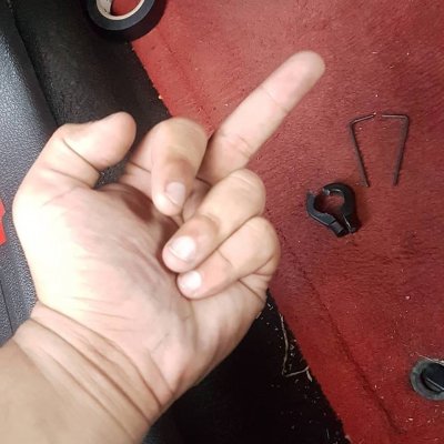

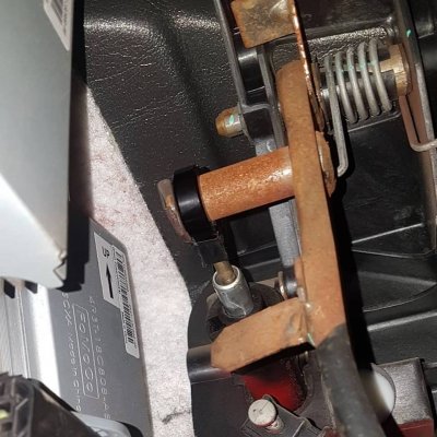

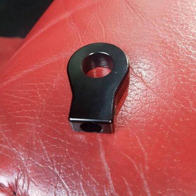

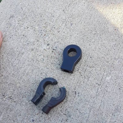

Well, I found out 1 of 2 issues.
The pivot point was worn out hence wasn't getting full press upon depressing the clutch.
Well, this happened yesterday on the highway.
Now that I installed the metal rod eye.. the clutch engaged and disengaged properly.
Except my engagement point is super high so the clutch is almost done.
rocky61201
Mar 25, 2009
1,170
764
SoCal
Where did you get that eye and does it have a set screw?
Yes I've broken the plastic one before too. I was going to use a metal eye I had lying around from an adjustable brake master cylinder pushrod but it didn't quite fit right.
