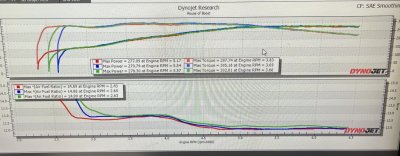

The CMDPs and UDPs will help the bottom end a little but the biggest HP/TQ gains from those are from 3000rpm upwards. The best choice of LT headers are the 1-5/8" full length versions as these produce the biggest TQ gains in the midrange as well as a decent HP gain at the top end.
The trick here is to maximize the area under the torque curve as much as possible while staying within the rwhp limit for ST4 racing i.e. minimum 12lb/rwhp. Therefore at a race weight of e.g. 3600lb it's 300rwhp.
@AHaze your tune will need to be adjusted for the above mods but looking at the A:F ratios on your dyno graph, it looks like it needs adjusting anyway as the engine's too rich from 4000rpm upwards (12.6-13.0 is optimal).
Not my dyno graph but good catch. I missed that completely.
