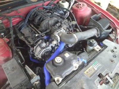

IMG_20220324_095256862.jpg IMG_20220322_173533848 (2).jpg I just completed a 4.0 resurrection on an 08 5 speed car. I found here in Florida, a guy who runs a small shop from home re manning 4.0's. $900 plus $150 core. My motor was locked up so it was not a usable core. I bought the car for 2K. Base coupe. I removed my dead motor and loaded it in my F150. Took it to him after talking to him. About a 3 hour drive. He gave me $50 for the heads. He goes through a good core, rings, bearings, gaskets, block honing, cleaning, all seals and gaskets, surfaces the heads after inspections, seals, etc. Upgrades all the timing gear parts as well. No water pump or thermo housing. Got my Aluminum one off Ebay. Blue hose kit, new radiator, belt, plugs, 8mm wire set. Added a Dynomax thrush muffler to quiet down the little boy fart can that was on it as well. Fired right up. Just coming up on my first oil change from break in. Zero problems except for the change from a 4 gauge cluster to a 6 gauge cluster, requiring a Forscan interface and download, and learning what the hell I'm doing. All's good except for a idle to 1500 rpm surge / stumble. The car came with cold air intake and I expect it was never reprogrammed. Working through that now. Another learning curve. I'm into the motor swap and all for around 2K. I remind you, I have done all the labor myself. This car is not an easy car to R & R a motor out of. I have no car lift. Just the car about 2 ft off the ground and my engine hoist and engine stand. I don't know that I would want to do it again at 64 years old.

Replace your plastic thermostat housing with an aluminum one. Run a 180-ish thermostat if you live anywhere warm with a fresh radiator, they are less than $100. The cam gears, chain, guides and tensioners are a weak point after 100k miles. Aftermarket have improvements for replacements. Even the FOMOCO replacements now are better than what came in them. Keep good clean oil and filter in it. That's part of what kills the tensioners is dirty contaminated oil. Keep an eye on your cooling system, waterpump, belt, etc. Don't run it hot. If you rebuild it or have your heads off use something like Cometic gaskets. The engines are very tough if you follow these things. But if you abuse it, hell you can break anything. I did all these things with my reman 4.0. A free flowing muffler, or real dual help it breathe. Don't put a fart can on it. The drone will make driving it unbearable. I have a Cold air intake on mine from the previous owner. It have a tuning problem that I'm working through. Don't do it unless you are willing to deal with the tune issue. Just my thoughts. These are recommends for street use of course.
