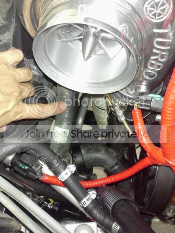

He has a 76. So he tapped the piping just down stream of the turbo.
Edit. Michael beat me to it lol
What line are you using?
Ur talkin bout your wastegate line? If its that black hose idk I bought gates vacuum line. Oil lines look good, yo are also pushin over 800hp lol
I used a heavy 1/4" ID fuel line for my WG/BOV lines. The wall of the hose is reinforced and a little thicker than normal hose, so it should resist flex/expansion a little better than normal vacuum lines.
