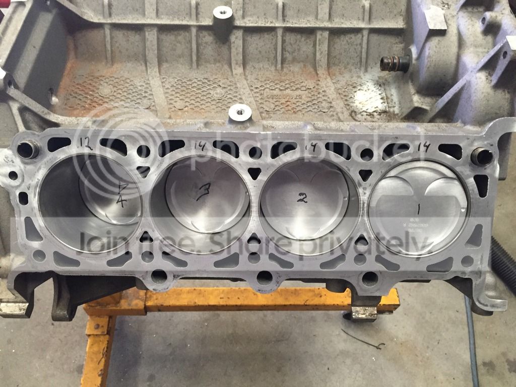

I now have a short block! However, I need some help on the correct torque spec for the boss connecting rods. What is the correct procedure?

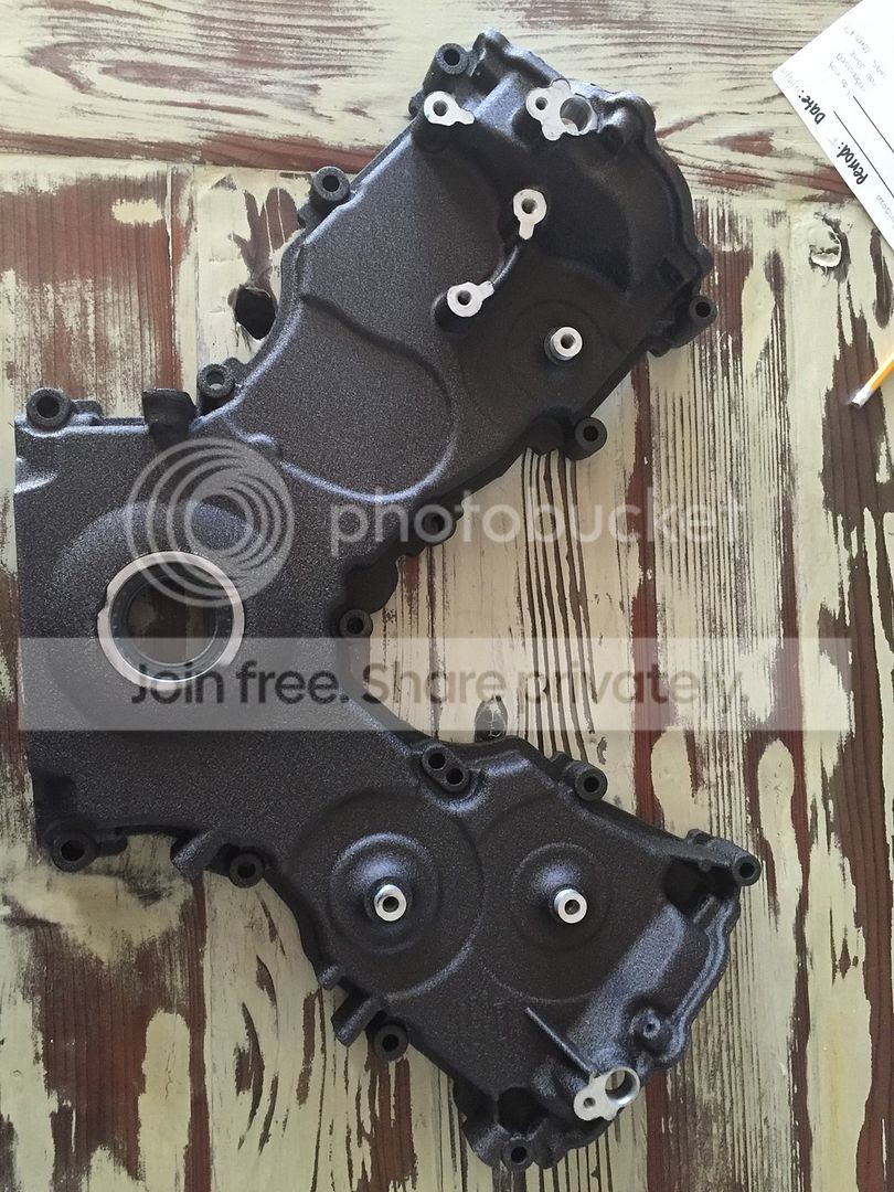

I also picked up the timing cover from the shop..
