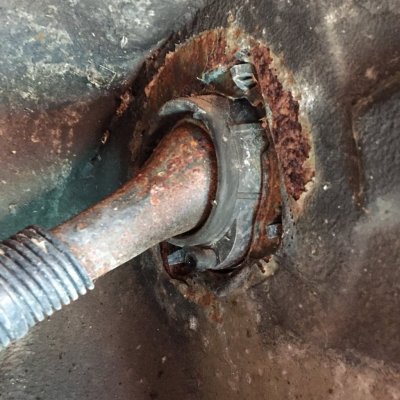

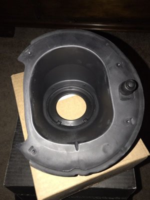

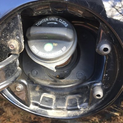

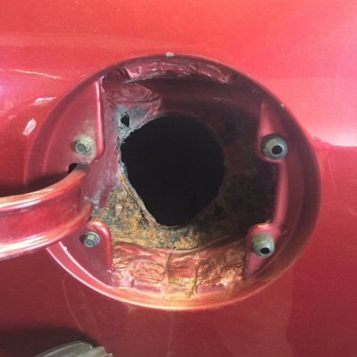

Wow, that kinda sounds dirty. Anyone have any clever fixes for the ole s197 rusty fuel pocket? It looks as tho it’s been repaired previously, and while I have it apart I figure I might as well add that to the list. Don’t see much for oem replacement, not really accessible fully in the trunk unless you can shrink yourself. So unless I go to a bone yard with some cutting tools there’s not much you can buy over the counter to remedy the situation. I’m toying around with the idea of taking a 2010-2014 s197 fuel pocket which is available for about 40 bucks and removing the affected area from my car and trimming and implanting the late model s197 fuel pocket. Thoughts?

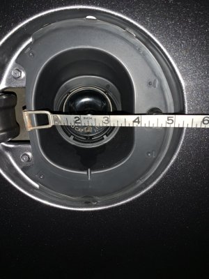

Dead in here. I at least expected one naysayer to give me some crap. Oh well. Moving right along. Here is a 2014 Fuel pocket for some reference.

Instances first arose around 07-08, guys who store their cars and wash and wax religiously started seeing paint bubble inside the fuel door. The way ford set this up is very dumb and allowed for water pool and intrusion in the fuel pocket. The real damage is hidden behind the filler neck mount. Ford was made well aware of it but never did anything short of remedying the situation in the late model s197 body overhaul. In the early s197 the fuel pocket is Seam sealed to the outer fender then then glued to the inner fender and the quarter is spot welded into its final resting place. In the late model s197 the fuel pocket fits into the rear quarter from the outside of the car, no water intrusion.

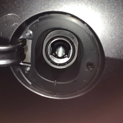

Looks like the later car has a tiny drain hole at the bottom of the door opening the earlier car doesn't.

Would it be possible to cut all the rusted stuff out and completely replace it with the capless system from the later S197?

I believe that’s the way I’m headed, the question is now, to take away material or add it. Thanks for commenting.
