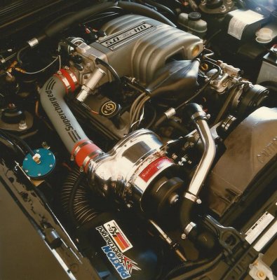

I did have a Paxton on my 89 GT. That was about $3000. It was a low pressure system. I like it because you could operate it like an air conditioner. I will see if I can find a picture of it.
LarryJM
Resident Fuktard
Jul 15, 2018
1,008
152
Old School Paxton. A low pressure system good enough for 13:80's.
